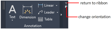

  • Docked horizontally at the top of the drawing area (default)
  • Docked vertically along the right or left edge of the drawing area
  • Undocked, or floating within the drawing area or on a second monitor

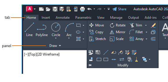

Ribbon Tabs and Panels
The ribbon is composed of a series of tabs, which are organized into panels that contain many of the tools and controls available in toolbars.

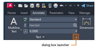

Some ribbon panels provide access to a dialog box related to that panel. To display the related dialog box, click the dialog box launcher is denoted by an arrow icon, , in the lower-right corner of the panel.

You can pull a panel off a ribbon tab and into the drawing area or onto another monitor. The floating panel remains open until you return it to the ribbon, even if you switch ribbon tabs.

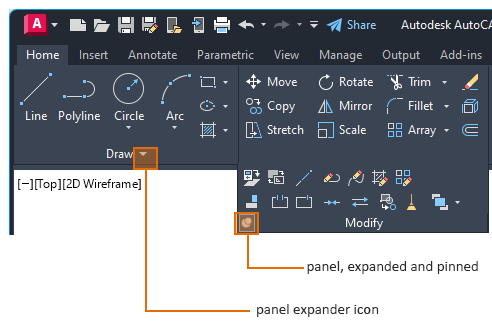

Slide-out Panels
If you click the arrow in the middle of a panel title, , the panel will expand to display additional tools and controls. By default, slide-out panels automatically close when you click another panel. To keep a panel expanded, click the push pin, , in the bottom-left corner of the slide-out panel.

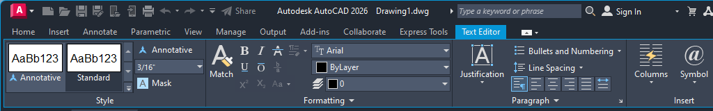

Contextual Ribbon Tabs
When you select a certain type of object or start certain commands, a contextual ribbon tab is displayed instead of a toolbar or dialog box. The contextual tab closes when you end the command.
