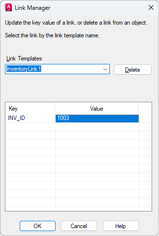

Link Manager (dbConnect Manager)
Edits the values of the key fields for a selected linked object.
Access Methods
dbConnect Links Link Manager (Select a linked graphical object)
Select and then right-click a linked graphical object, and then choose Link Link Manager
List of Options
The following options are displayed.
Link Templates
Lists all link templates that are associated with the selected graphical object. Select the link template whose link values you want to view or edit.
Key
Displays the key fields of the currently selected link template.
Value
Displays all key values that are defined for the selected link. To display a list of values for a specific field, click a Value cell and choose [...].
Delete
Deletes the currently selected link from the graphical object it's associated with.
