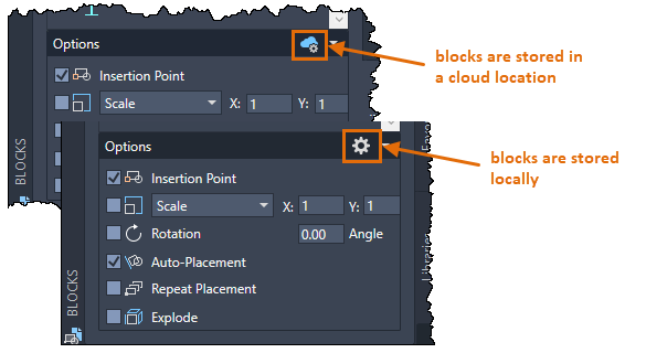

Block Sync Settings
Displays the Block Sync Settings dialog box. Use this dialog box to set the path of the recent and favorite block libraries and control the permission over the use of the cloud storage user name.
Note: The Block Sync Settings button at the bottom of the Blocks palette is dynamic and changes depending on the current location of your recent and favorite blocks.
