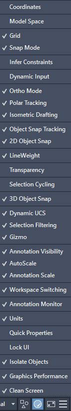

Find Isolate Objects Hide selected objects in the drawing area, or display objects that were hidden previously.
Find Customization Specifies what command buttons to display on the status bar.
