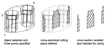

Create a 2D region object that represents a planar cross section through a 3D solid object
You can create a 2D region object that represents a planar cross section through a 3D solid object. You do not have live sectioning capabilities when you use this method.
  1. At the Command prompt, enter SECTION.
  2. Select the object to cross section.
  3. Specify three points to define the cross-sectional plane.
