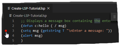

- Line Breakpoint
- Switch to Visual Studio Code.
- In the editor window, in the left margin, click to the left of Line 3 to add a breakpoint at the beginning of the code statement on that line.
A red circle appears indicating a breakpoint has been added.
- Switch to AutoCAD.
- At the Command prompt, enter
hello.
The hello function is started and code execution is interrupted at the line with the breakpoint.

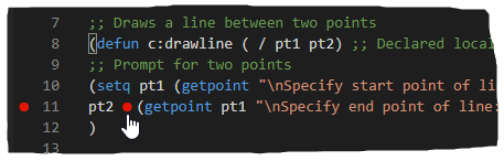

- Inline Breakpoint
- In the editor window, on Line 11, click to the left of the opening parenthesis.
- Right-click and choose Add Inline Breakpoint to add a breakpoint at the beginning of the nested AutoLISP expression.
- At the Command prompt, enter drawline.
- Specify a point for the start point of the line.
After specifying the first point, execution is interrupted by the inline breakpoint.

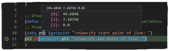

- Specify the start point of the line.
- Move the cursor over the
pt1 variable above or in the highlighted statement to view the current value assigned to the variable.
- On the Debug toolbar, click Step Into.
- Switch back to AutoCAD and specify the second point.
- Switch back to Visual Studio Code and click Step Into again on the Debug toolbar.

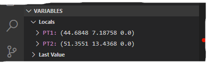

- View the value assigned to the
pt2 variable.
Along with positioning the cursor over a variable to view its current assigned value in a tooltip, the values assigned to all local variables can be viewed in the Variables section on the Run view.
