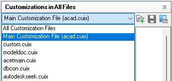

Before you can add custom commands to a CUIx file, you must set a CUIx file as the working file.
  1. In the Customize tab, Customizations In <file name> pane, click the down arrow on the Customization Files drop-down list.
  2. Select Main Customization File <file name> or one of the loaded CUIx files to set it as the working CUIx file.
    All new commands created are added directly to the working CUIx file. If the CUIx file that you want to work with is not loaded, select Open from the Customization Files drop-down list. Then browse to and select the CUIx file you want to work with.

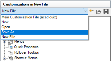

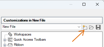

  1. In the Transfer tab, in the right pane, click the Create a New Customization File button.
  2. In the right pane, select Save As from the drop-down list.
  3. In the Save As dialog box, specify the location to save the new customization file to and enter a name in the File Name box.
  4. Click Save to create the customization file.

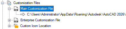

Designate the Main or Enterprise Customization (CUIx) File
  1. Click the Application menu Options.
  2. In the Options dialog box, Files tab, click the plus sign (+) next to Customization Files to expand the node.
  3. Click the plus sign (+) next to Main Customization File or Enterprise Customization File to expand it.
  4. Select the item below the node you expanded and click Browse.
  5. In the Select a File dialog box, browse to and select the customization file to load. Click Open.
    The file you selected is now designated as the main or enterprise customization file for the program.
  6. Click OK.
