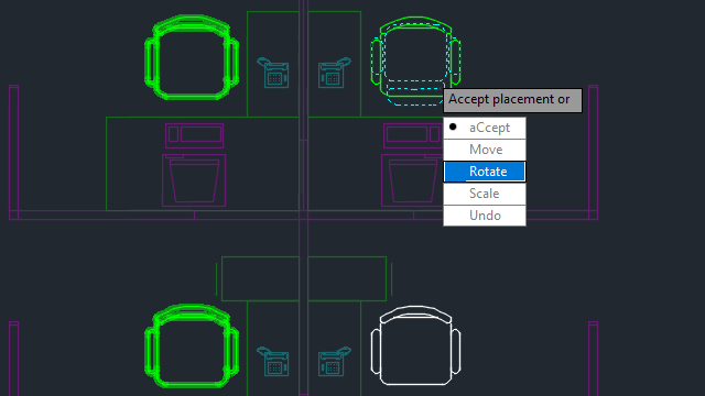

When you select geometry for conversion, AutoCAD finds and highlights all instances of the same geometry. You can then choose to convert the selected object and the found instances into a block.
To exclude certain instances from the conversion, click them individually to remove them from the process.

After selecting an existing block definition, you can adjust the scale and rotation to determine how the selected block definition replaces the found instances.

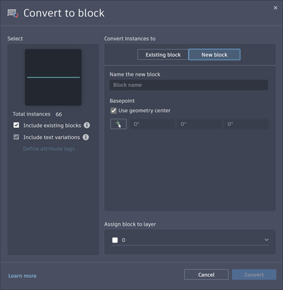

Convert to a New Block
You can also convert the source object or the selected instances to a new block. In the Convert dialog box, define a new block by specifying a block name and insertion point. By default, the insertion point is set to the center of the selected geometry.
