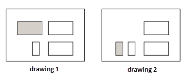

During the comparison process, the DWG Compare feature identifies objects that have been modified, added, or removed between the two drawings. For example, consider these two highly simplified drawings. Each drawing has differences that are not in the other drawing.
Let's say that drawing 1 is the previous version of a drawing and drawing 2 is the current drawing.

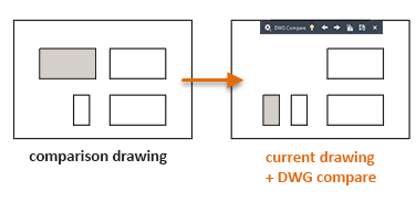

When the COMPARE command is started, the DWG Compare toolbar displays at the top of the drawing area when you specify the comparison drawing, drawing 1 in this example.
The result of the comparison is displayed in the current drawing as shown below.

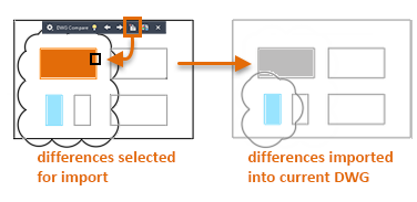

Import Differences into the Current Drawing
From the DWG Compare toolbar, you can import differences from the compared drawing into the current drawing. Only those objects that are different in the comparison drawing can be imported into the current drawing.
Imported differences automatically turn gray because they are now present in both drawings.

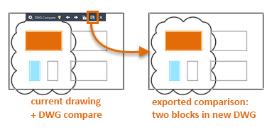

Export the Comparison Result
You can export the results of a comparison into a new snapshot drawing for reference. The snapshot drawing maintains the visual appearance of the comparison and is named using a combination of the drawing names.
Note: The snapshot drawing contains two blocks, one for each of the two compared drawings.
