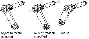

With the Rotate method, you can rotate objects in 2D about a specified point.
The direction of rotation is determined by the WCS. The Rotate3D method rotates objects in 3D about a specified axis. The Rotate3D method takes three values as input: the WCS coordinates of the two points defining the rotation axis and the rotation angle in radians.
To rotate 3D objects, use either the Rotate or Rotate3D method.
Create a 3D box and rotate it about an axis
This example creates a 3D box. It then defines the axis for rotation and finally rotates the box 30 degrees about the axis.
