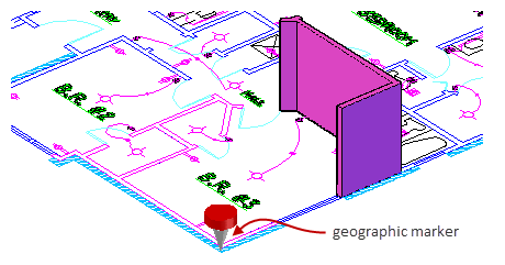

Inserting geographic location information to a drawing file makes points within the drawing correspond to geographic locations on the surface of the Earth.

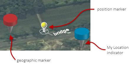

Geographic location information in a drawing file is built around an entity known as the geographic marker. The geographic marker points to a reference point in model space that corresponds to a location on the surface of the earth of known latitude and longitude. The program also captures the direction of the north at this location. Based on this information the program can derive the geographic coordinates of all other points in the drawing file.

After you insert a geographic marker in a drawing, you can:

  • Use position markers to mark geographic locations and record related notes.
  • Locate yourself on the map in real-time on systems that support location sensing.

Note: The geographic marker cannot be selected, but you can control its visibility using the GEOMARKERVISIBILITY system variable.
You can remove geographic location information from a drawing file using the GEOREMOVE command. The geographic marker and GIS coordinate system are removed from the drawing file. However, position markers continue to remain in the drawing file.
