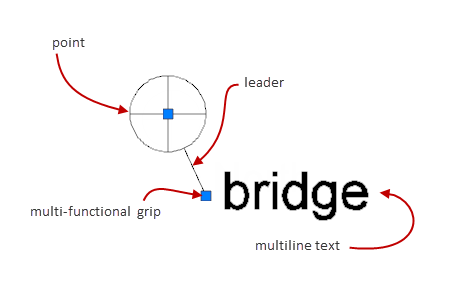

Places a position marker at a specified point in model space.
Find
This command is equivalent to the Point option of the GEOMARKPOSTION command.
Position markers are annotations that indicate and label locations. A position marker typically consists of a point, a leader line, and multiline text.
This command is available only if the drawing file contains geographic location information.
The following prompts are displayed.
- Specify a point
- Specifies the location of the position marker. You specify the coordinates as x and y values or click the location in model space.
