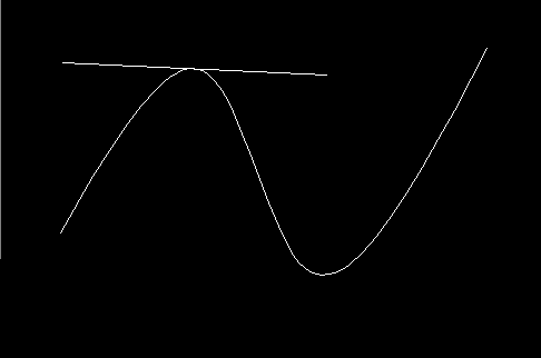

Assume that splineObj points to the spline in the following drawing:
Sample curve (spline) for vlax-curve-getDistAtParam
Obtain the start parameter of the curve:
(setq startSpline (vlax-curve-getStartParam splineObj))
0.0
The curve starts at parameter 0.
Obtain the end parameter of the curve:
(setq endSpline (vlax-curve-getEndParam splineObj))
17.1546
The curve's end parameter is 17.1546.
Determine the distance to the parameter midway along the curve:
(vlax-curve-getDistAtParam splineObj
   ( / (- endspline startspline) 2))
8.99417
The distance from the start to the middle of the curve is 8.99417.
