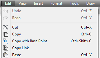

In the following example, the Undo and Redo menu items are disabled.
