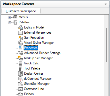

  2. In the Customize tab, Customizations In <file name> pane, expand Workspaces, and select the workspace containing the palette that you want to modify.
  3. In the Workspace Contents pane, click the plus sign (+) next to Palettes to expand it.
  4. Select the palette that you want to modify.

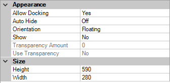

  5. In the Properties pane, do any or all of the following:
    • In the Show box, select an option (No, Yes, or Do Not Change).
    • In the Orientation box, select an option (Floating, Top, Bottom, Left, or Right).
    • In the Allow Docking box, select an option (No, Yes, or Do Not Change).
      Note: To specify that a window should be anchored, set Orientation to Left, Right, Top, or Bottom, and set Auto Hide to On.
    • In the Auto Hide box, select an option (On, Off, or Do Not Change).
    • In the Use Transparency box, select an option (No, Yes, or Do Not Change).
    • In the Transparency Amount box, enter a number (if applicable).
    • In the Default Group box, select a tool palette group (Tool Palettes window only).
    • In the Height box, enter a number. A value of 0 is equivalent to Do Not Change.
    • In the Width box, enter a number. A value of 0 is equivalent to Do Not Change.
