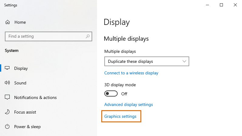

  1. Right-click the desktop and choose Display settings.
  2. Scroll down and click Graphics settings.

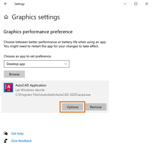

  3. Click Browse and then navigate to and select the software executable. As an example, for AutoCAD 2025, this would be C:\Program Files\Autodesk\AutoCAD 2025\acad.exe. Double-click acad.exe to add it to the list.

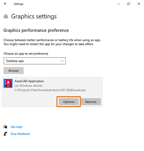

  4. Click the AutoCAD application, then click Options.

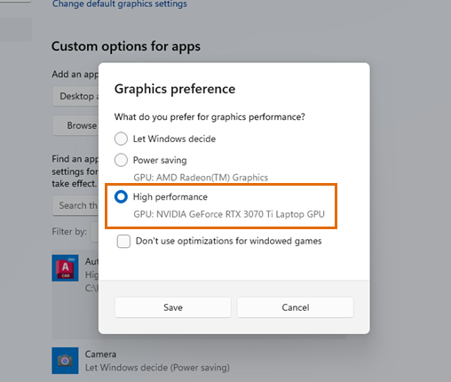

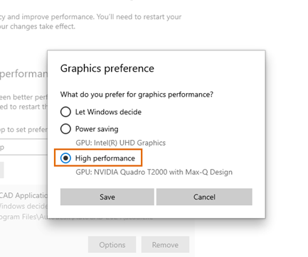

  5. Select the High-Performance option, then click Save and close the Settings panel.

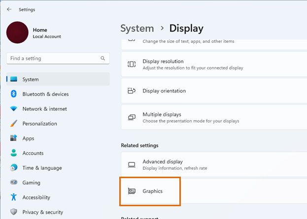

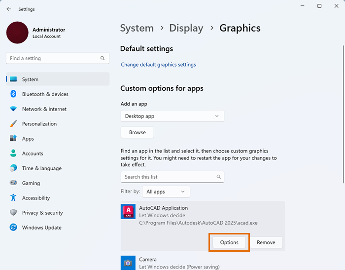

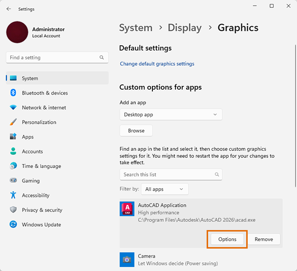

  2. Scroll down and click Graphics.
