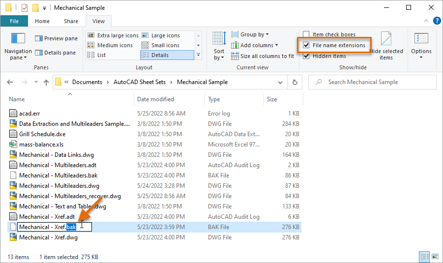

Note: Backup (BAK) and Automatic Save (SV$) drawing files cannot be opened directly in AutoCAD. You must change their file extension from BAK or SV$ to DWG before they can be opened.
The following steps explain how to change the extension of a BAK or an SV$ file in Windows:
  1. Right-click over the Windows Start button and choose File Explorer.
  2. Navigate to the BAK or SV$ file whose extension you want to change.
  3. Select the file and press F2.
  4. Highlight the extension of bak or sv$, and then enter dwg.
    Note: If the extension isn’t displayed in File Explorer, click the View tab and then check File Name Extensions.

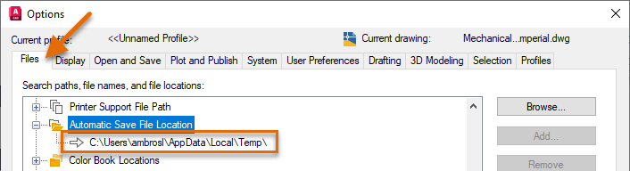

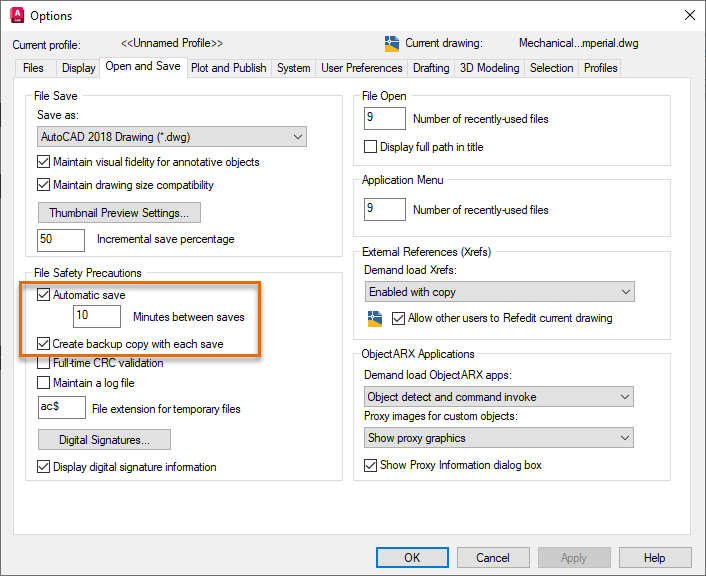

The following steps explain how to change the Drawing Backup and Automatic Save feature settings in the Options dialog box that control the creation of BAK and SV$ files as you work on a drawing:
  1. Right-click in a drawing window and choose Options.
  2. In the Options dialog box, Files tab, scroll down and click + next to the Automatic Save File Location node.
    The location in which SV$ files are stored can be seen. You can change the location by selecting the path under the node and clicking Browse.
  3. Click the Open and Save tab.
  4. Under the File Safety Precautions section, make sure Automatic Save and Create Backup Copy with Each Save are checked.
  5. If you want to change the time interval of the Automatic Save feature, click in the Minutes Between Saves text box and replace the current value.
    I like to use a value of 5 minutes to limit the amount of rework that I would have to do if something unexpected happens, but I save very frequently so I don’t always end up with an SV$ file until I walk away for a meeting or lunch.
    Note: Be careful at setting the value too large. If you don’t save frequently, you run the risk of losing a lot of work that would have to be redone if your workstation or the program shutdown unexpectedly.
  6. Click OK to save the changes.

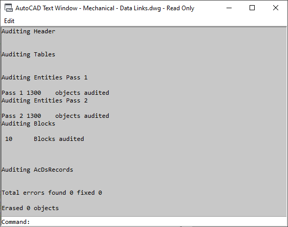

The following steps explain how to audit a drawing:
  1. Open the drawing file to audit, such as the Mechanical - Data Links.dwg sample drawing from the C:\Program Files\Autodesk\AutoCAD <release>\Sample\Mechanical Sample folder.
  2. Click Open. If prompted to open the drawing as read-only, click Yes.
  3. Click the Application button > Drawing Utilities > Audit. Find
  4. At the Fix any errors detected? [Yes/No] <N>: prompt, enter y to fix the errors detected during the audit or enter n to ignore and only report the errors detected.
  5. Press Ctrl+F2 to open the AutoCAD Text Window or press F2 to expand the Command Line window.
    The audit summary report is shown in the window.

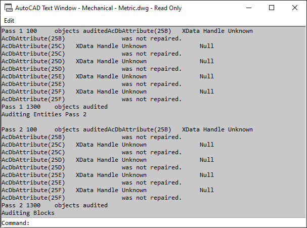

    The following images show the audit report for two different drawing files; one with no errors detected and another with errors detected and fixed.

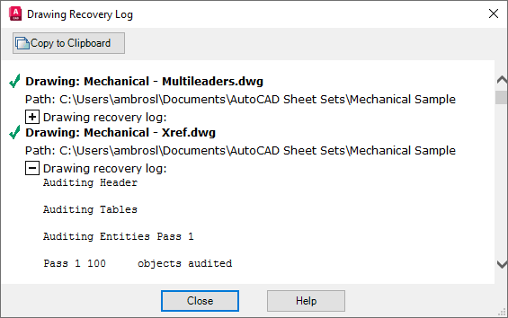

Recover a Drawing

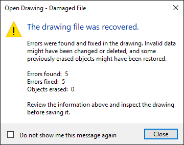

While trying to open a drawing file, AutoCAD might encounter a problem that results in a failure to open the drawing. In these situations, you can’t run the AUDIT command and check the drawing for errors. Instead, you use the Recover Drawing feature which performs an audit on the objects in a drawing as it is being opened and any errors detected are fixed as they are encountered.
The following steps explain how to recover a drawing file:
  1. Click the Application button > Drawing Utilities > Recover > Recover. Find
  2. In the Select File dialog box, browse to and select the drawing file to recover, such as Mechanical - Data Links.dwg sample drawing from the C:\Program Files\Autodesk\AutoCAD <release>\Sample\Mechanical Sample folder.
  3. Click Open. If prompted to open the drawing as read-only, click Yes.
  4. Review the audit information shown in the Open Drawing – Damaged File message box and click Close.
    If the drawing you opened contains errors, the number of errors found and fixed is displayed along with the number of objects erased because they couldn’t be fixed.
  5. If you want to view the detailed audit summary report, press Ctrl+F2 to open the AutoCAD Text Window or press F2 to expand Command Line window.

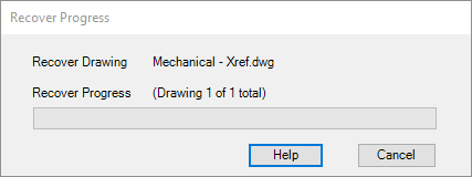

Along with recovering a drawing file, you can also recover a drawing file and its attached Xrefs. To recover a drawing file along with all attached Xrefs, do the following:
  1. Click the Application button > Drawing Utilities > Recover > Recover with Xrefs. Find
  2. In the Recover All message box, click Recover the Drawing File.
    Note: When recovering a drawing file along with its Xrefs, the Xrefs are saved to the latest drawing file format. If drawing file compatibility is critical, you can resave all drawings to a specific drawing file format using the DWG Convert utility (DWGCONVERT command).
  3. In the Select File dialog box, browse to and select the drawing file to recover, such as Mechanical - Multileaders.dwg sample drawing from the C:\Program Files\Autodesk\AutoCAD <release>\Sample\Mechanical Sample folder. Click Open.
    The Recover Progress message box is displayed and informs you of the audit progress for the xref files attached to the drawing.
  4. In the Drawing Recover Log message box, review the audit summary report of the drawing and its attached Xrefs. Click Close to close the message box.

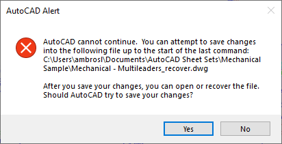

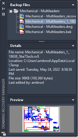

Recover Drawings After an Unexpected Closure
If AutoCAD shuts down unexpectedly, the next time the program starts, it should inform you that it was shutdown unexpectedly and it opens the Drawing Recovery Manager automatically. The Drawing Recovery Manager lists all the drawing files that were open along with any BAK or SV$ files associated with those drawings.
Note: Drawings that are open but not saved at least once before the program shutdown unexpectedly are not tracked by the Drawing Recovery Manager. Be sure to save your work after you begin, and regularly thereafter.
Note: While the Drawing Recovery Manager should open automatically, it can be opened by clicking the Application button > Drawing Utilities > Open the Drawing Recovery Manager. Find
For each drawing listed, expand the top-level node to open and view the properties for the following files if they exist:
  • DrawingFileName_recover.dwg
  • DrawingFileName_a_b_nnnn.sv$
  • DrawingFileName.dwg
  • DrawingFileName.bak
Tip: BAK and SV$ files can also be renamed and opened outside of the Drawing Recovery Manager. See the Backup and Automatically Save Drawing Files section earlier in this topic.
Note: After opening a drawing file from the Drawing Recovery Manager, it is recommended to perform an audit on the drawing to check for errors before continuing to work on the drawing.

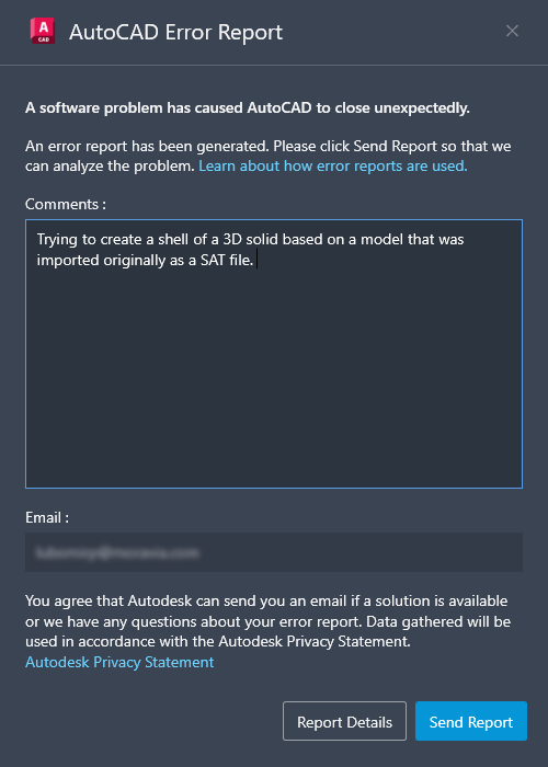

Report Errors
While we hope it never happens, there might be a time when AutoCAD encounters a problem and shuts down unexpectedly. When this happens, you should be prompted to save each open drawing that has unsaved changes. These drawings will have "_recover" appended to their names to ensure the previously saved drawing file is not overwritten.
After saving any open drawings with unsaved changes, the AutoCAD Error Report dialog box should be displayed. From this dialog box, you can send us an error report. The error report includes information about the current state of the program and your workstation and can include optional information, such as what you were doing at the time of the error. Error reports are used to improve the stability of the product.
Here is the AutoCAD Error Report dialog box with some optional information entered:
Note: The REPORTERROR system variable is used to control the display of the Error Report dialog box after AutoCAD encounters an error and shuts down unexpectedly.
