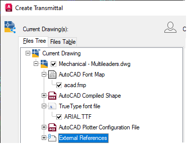

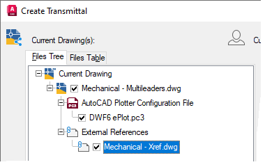

  4. In the Create Transmittal dialog box, click the Files Tree tab.
    This view shows the relationship of the referenced files to the current drawing file.

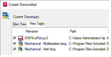

  5. Click the Files Table tab.
    This view shows a full list of all files to be included in the transmittal package.
  6. On the Files Table tab, clear the checkbox next to the DWF6 ePlot.pc3 item to exclude it from the transmittal package.
    DWF6 ePlot.pc3 is part of the standard AutoCAD installation, so you don’t need to share it with others.

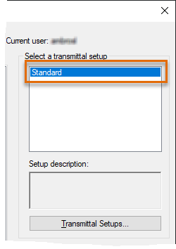

  7. In the Select a Transmittal Setup section, select Standard.
    A transmittal setup defines the settings that will be used to define the transmittal package, and how the drawing and its associated files are to be updated.

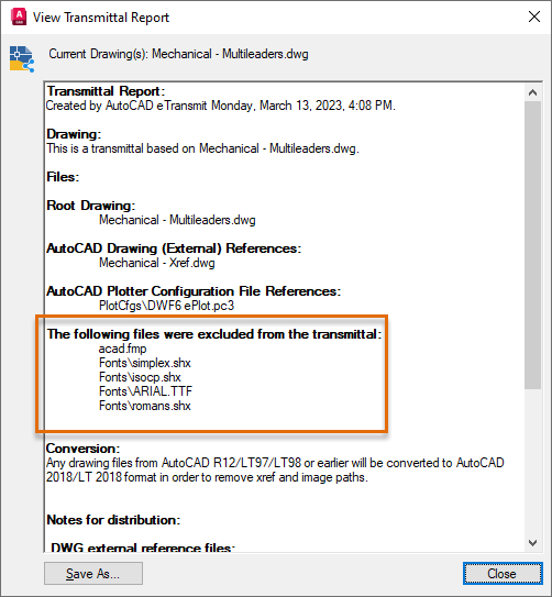

  8. In the lower-left corner of the dialog box, click View Report.
  9. In the View Transmittal Report dialog box, review the report and then click Close.
    This report provides information about the files to be included in the transmittal package along with those that were identified but are currently excluded. Files that might be identified and excluded by default are font or unloaded reference files.

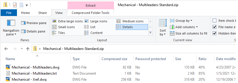

  10. In the Create Transmittal dialog box, click OK.
  11. In the Specify Zip File navigation dialog box, browse to your Documents folder or another location in which to save the ZIP file. Enter a name for the ZIP file and click Save.

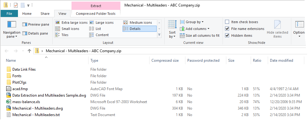

  12. In File Explorer, browse to the ZIP file and double-click it.
    The contents of the ZIP file are displayed in the window and you can see how those files are structured.
    Note: The TXT file in the ZIP file is a copy of the report shown in the Create Transmittal dialog box.

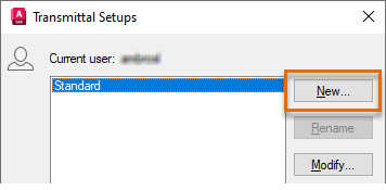

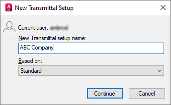

  3. In the Create Transmittal dialog box, under the Select a Transmittal Setup section, click Transmittal Setups.
  4. In the Transmittal Setups dialog box, select the Standard transmittal setup and click New.
    If you want to modify an existing transmittal setup, select the transmittal setup from the list and click Modify.
  5. In the New Transmittal Setup dialog box, New Transmittal Setup Name text box, replace the default name with ABC Company. Click Continue.

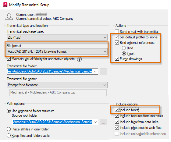

  6. In the Modify Transmittal Setup dialog box, make the following changes:
    1. Under Transmittal Type and Location, click the File Format drop-down list and choose AutoCAD 2013/LT 2013 Drawing Format.
      Note: Saving drawings to an older format could cause the loss of formatting and objects that are not supported in an earlier release.
    2. Under the Actions section, check:
      1. Set Default Plotter to 'None'
      2. Bind External References and choose Insert
      3. Purge Drawings
    3. Under the Include Options section, check Include Fonts.

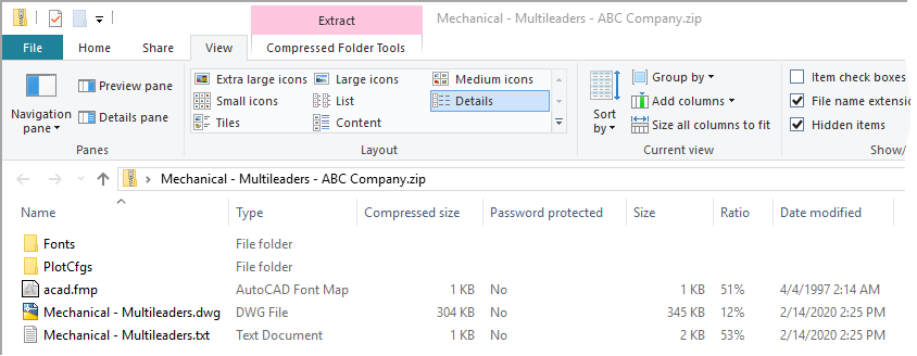

    Notice the changes to the Files tree, the files related to the fonts used in the drawing are now part of the transmittal package.
    Important: When including fonts, the individuals receiving them might require a license before they can legally use them.

  10. Specify a name and location for the transmittal package, and then open the ZIP file and review the files.

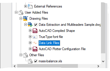

Adding Other Files to a Transmittal Package
Projects often include more than one drawing, complex projects can include tens or hundreds of drawings. Along with drawings and the files they reference, projects commonly contain non-drawing files, such as product specifications, contracts, project timelines, and more.
In this exercise, you manually add a second drawing and a Microsoft Excel spreadsheet to be included in the transmittal package.
  1. Re-open C:\Program Files\Autodesk\AutoCAD <release>\Sample\Mechanical Sample\Mechanical - Multileaders.dwg, if you previously closed it.
  2. Click the Application menu > Publish > eTransmit. Find
  3. In the Create Transmittal dialog box, under the Select a Transmittal Setup section, select ABC Company.

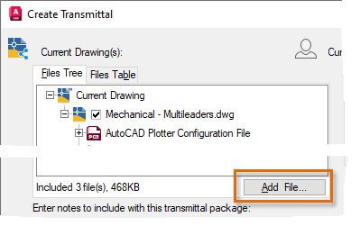

  4. Below the Files Tree and Files Table tabs, click Add File.
  5. In the Add File to Transmittal navigation dialog box, browse to C:\Program Files\Autodesk\AutoCAD <release>\Sample\Mechanical Sample.
  6. Hold the Ctrl key down and then select the Data Extraction and Multileaders Sample.dwg and mass-balance.xls files. Click Open.
    The selected files and those they reference are added.
  7. Click OK to create the transmittal package.
  8. Specify a name and location for the transmittal package, and then open the ZIP file and review the files.

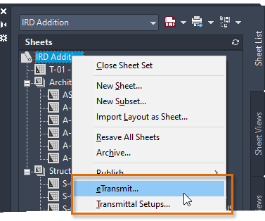

If the current drawing is part of a sheet set, the sheet set data (DST) and its support files are also included in the transmittal package. When creating a transmittal package of the files in a sheet set, it is recommended to use the eTransmit feature in the Sheet Set Manager rather than the ETRANSMIT command. Right-click on the sheet set node in the Sheet Set Manager and choose eTransmit to package all drawing and support files in the sheet set. A sheet set can also contain transmittal setups, this makes it easier to share the transmittal settings with others working on a project.
