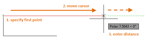

Polar Tracking
When you need to specify a point, such as when you create a line, use polar tracking to guide the movement of your cursor in certain directions.
For example, after you specify the first point of the line below, move your cursor to the right, and then enter a distance in the Command window to specify a precise horizontal length for the line.
By default, polar tracking is turned on and guides your cursor in a horizontal or vertical direction (0 or 90 degrees).

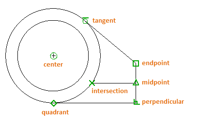

Object Snaps
By far, the most important way to specify precise locations on objects is to use object snaps. In the following illustration, several different kinds of object snaps are represented by markers.
Object snaps become available during a command whenever AutoCAD prompts you to specify a point. For example, if you start a new line and move your cursor near the endpoint of an existing line, the cursor will automatically snap to it.

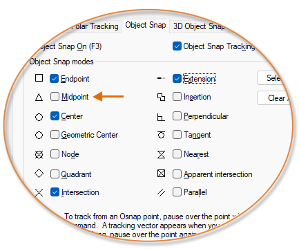

Set Default Object Snaps
Enter the OSNAP command to set the default object snaps, which are also called "running" object snaps. For example, you might find it useful to turn on the Midpoint object snap by default.

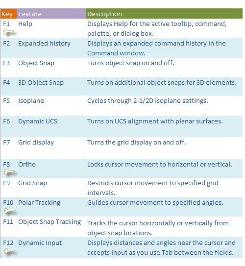

Handy Function Key Reference
The keyboard function keys all have assignments in AutoCAD. The ones that are most commonly turned on and off are indicated with a key.
