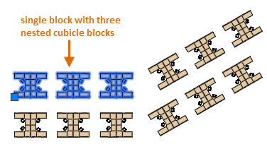

current drawing. For example, you might want to create a block from a set of objects that appear repeatedly in that drawing, such as the following cubicle arrangement that contains multiple
nested blocks. All the blocks used in the cubicle arrangement can be combined into a
single block for multiple placements.

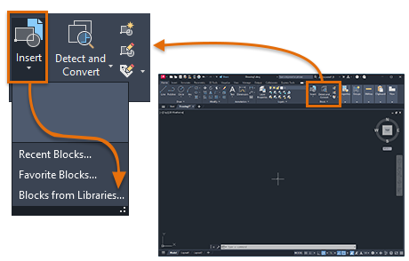

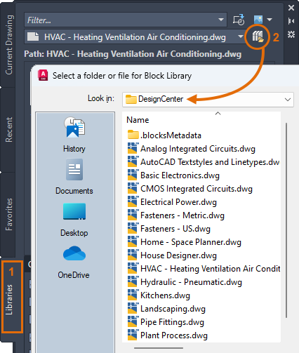

- Click Insert from the Home tab and click Blocks from Libraries. This starts the BLOCKSPALETTE command.

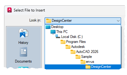

- Click the Browse button to display a folder or file selection dialog box.
- Navigate to the DesignCenter folder where a variety of sample drawings are stored.

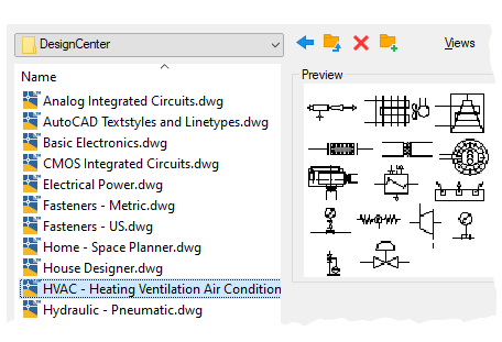

Each drawing in the DesignCenter folder contains a set of related block definitions.
Select a drawing file that interests you.

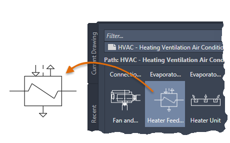

For example, let's say you create drawings for heating, ventilation, and air conditioning. Select the HVAC drawing and then click Open.
- From the Blocks palette, Libraries tab, click and place several of the blocks.
This action copies the selected block definition from the block library drawing into your current drawing and inserts a block reference. Inserting additional block references will now be much faster. To specify a different drawing file, use the Browse control as before.
- To choose a different library drawing from the DesignCenter folder, make sure that the Libraries tab is current (1) and click the file navigation button (2).

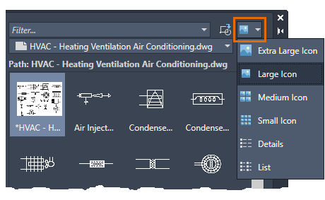

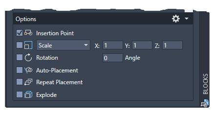

- Experiment with the other controls. For example, try changing the preview control.

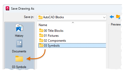

Often, individual drawing files are created to be used as blocks and saved in a folder with similar drawing files. This method is an alternative to accessing the block definitions stored in a single drawing.
When you create a drawing file for use as a block, make sure that you locate an object at the origin point (0,0). This will serve as the default base point of the block. Later, when you insert the block, it is attached to your cursor at the base point.

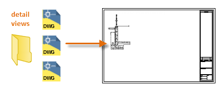

In the following example, a drawing file is inserted into the current drawing to provide a standard detail view.
Custom title blocks and drawing borders are also created as drawing files that can be inserted later or included in drawing template files.
