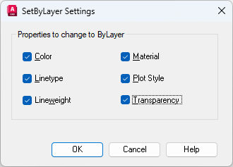

SetByLayer Settings Dialog Box
Changes property overrides for color, linetype, lineweight, material, plot style, and transparency to ByLayer for selected objects and inserted blocks on unlocked layers.
SETBYLAYER (Command) Find: Settings
List of Options
The following options are displayed.
Color
Changes the color of selected objects to ByLayer. (SETBYLAYERMODE=1)
Linetype
Changes the linetype of selected objects to ByLayer. (SETBYLAYERMODE=2)
Lineweight
Changes the lineweight of selected objects to ByLayer. (SETBYLAYERMODE=4)
Material (not available in AutoCAD LT)
Changes the material of selected objects to ByLayer. (SETBYLAYERMODE=8)
Plot Style
Changes the plot style of selected objects to ByLayer. This option is available in named plot style drawings. (SETBYLAYERMODE=16)
Transparency
Changes the transparency value of selected objects to ByLayer. (SETBYLAYERMODE=128)
