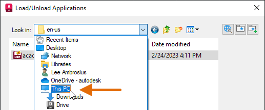

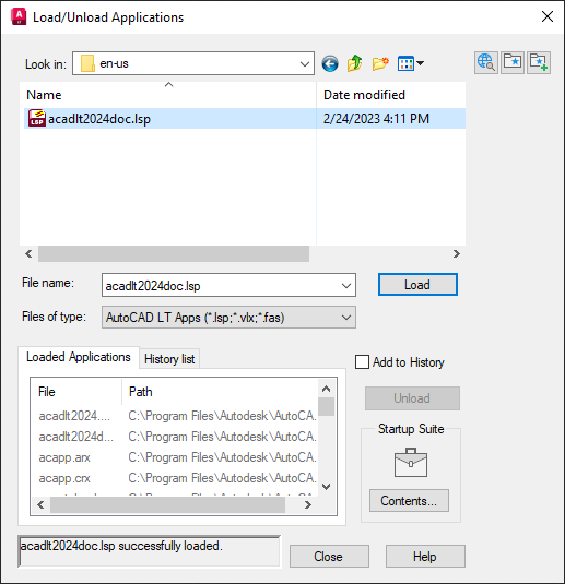

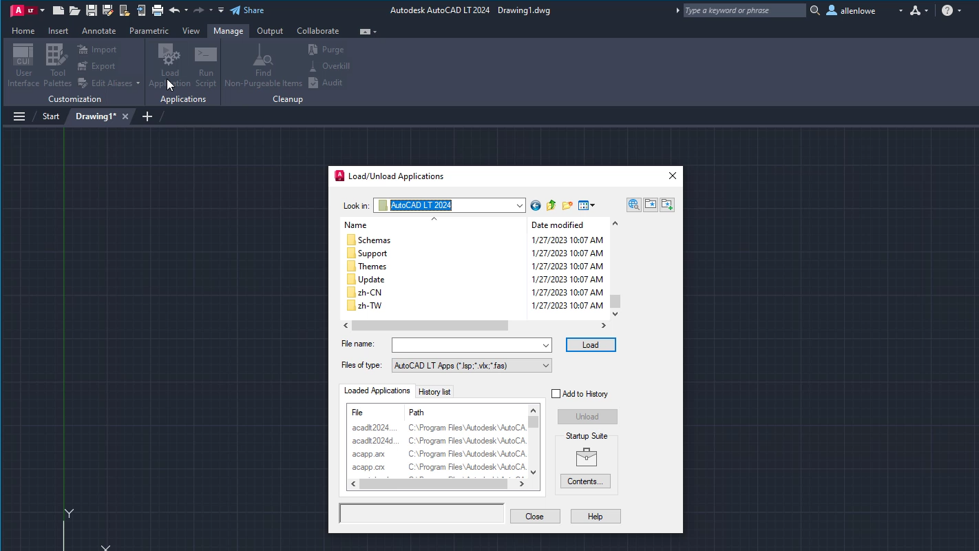

  1. In AutoCAD LT, click Manage tab > Applications panel > Load Application. Find
    APPLOAD could also be entered at the Command prompt.
  2. In the Load/Unload Applications dialog box, click the Look In drop-down list and select This PC.
  3. In the Folders and Files list, navigate to C:\Program Files\Autodesk\AutoCAD LT <release>\Support\en-us.
    If you have a different language installed other than English, such as jp-jp, then select that folder instead of en-us.
  4. Select acadlt2024doc.lsp and click Load.

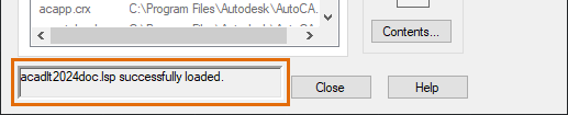

    The acadlt2024doc.lsp file is one of the specially named AutoLISP files that AutoCAD LT searches for and loads if found into each drawing that is opened or created. This AutoLISP file contains some commands and custom AutoLISP functions used by the product. Here, I'm just using it as an example file.
    In the message box, "acadlt2024doc.lsp successfully loaded." is displayed in the lower-left corner of the dialog box and in the command line window.
  5. Click Close.

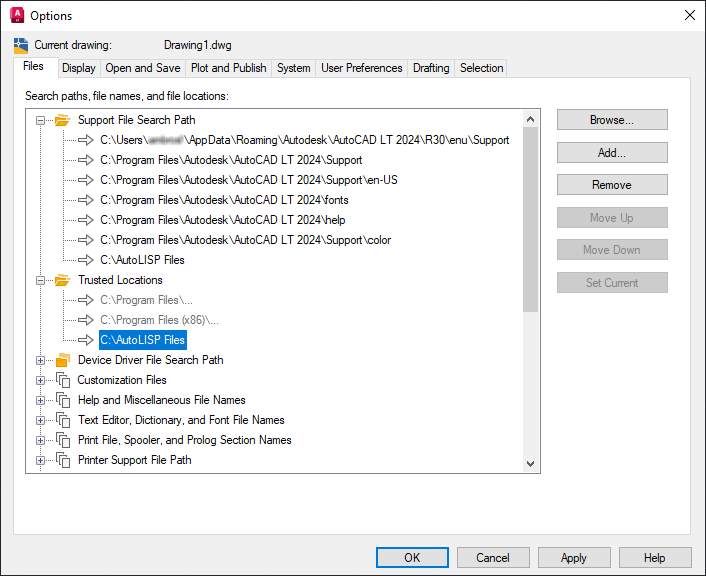

The following steps show how to add the folder C:\AutoLISP Files to the Support File Search Path and Trusted Locations settings. You will use this location later to create an LSP file with a few short AutoLISP programs.
  1. In File Explorer, create the folder AutoLISP Files on the C:\ drive or in a location that you have write access, such as Documents.

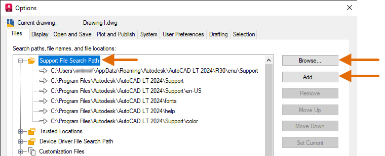

  2. In AutoCAD LT, right-click the drawing area and select Options. Find
  3. In the Options dialog box, Files tab, expand and select the Support File Search Path node.
    The listed folders are where AutoCAD LT looks for your AutoLISP files among other types of custom files used to store hatch patterns, linetypes, command aliases, and define new user interface elements.

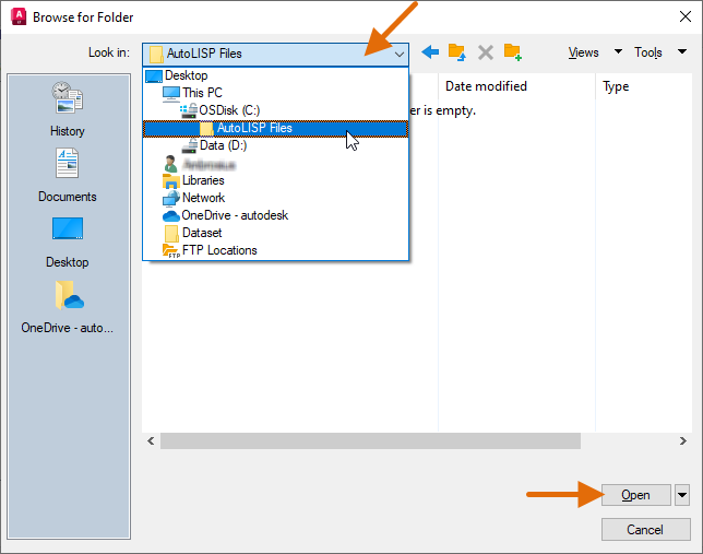

  4. Click Add and then Browse on the right-side.
  5. In the Browse for Folder dialog box, navigate to C:\AutoLISP Files or the folder that contains your AutoLISP files.
  6. Select the folder that contains your AutoLISP files and click Open.
    The folder is added to the bottom of the list.
    Note: AutoCAD LT searches the list from top down for custom files. In most cases, you don't need to reorder the folders unless you want to replace one of the standard customization files with one of your own.

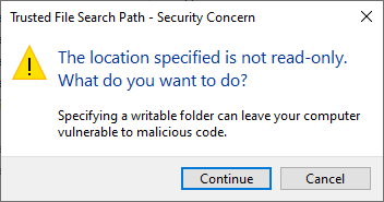

  7. Select the Trusted Locations node and add the C:\AutoLISP Files folder or the folder that contains your AutoLISP files. Follow steps 4 through 6 to add the folder.
  8. If the Trusted File Search Path – Security Concern message box is displayed, click Continue.
    Remember: It is recommended to mark the folder where you store your AutoLISP files as read-only.
  9. Click OK to save the changes and exit the Options dialog box.

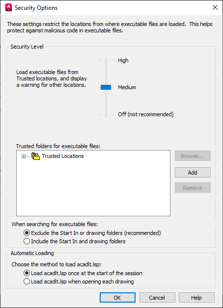

In addition to marking the folders with your AutoLISP files as read-only and identifying those folders as trusted, AutoCAD LT also offers some additional settings that help to secure AutoCAD LT from malicious code and malware. You can access the Security settings of AutoCAD LT by doing the following:
  1. In AutoCAD LT, right-click in the drawing area and select Options. Find
  2. In the Options dialog box, System tab, under the Security panel, click Security Options.
  3. Change the Options as needed under the Security Level and Automatic Loading sections.
    1. Security Level – Controls the restrictions applied to loading executable programs (SECURELOAD system variable)
    2. Trusted Folders – Folders in which AutoCAD is allowed to load executable programs when Security Level is medium or higher (TRUSTEDPATHS system variable)
    3. When Searching for Executable Files – Controls whether AutoCAD LT looks for AutoLISP files in the Start In folder defined by the desktop shortcut or the folder on an open drawing (LEGACYCODESEARCH system variable)
    4. Automatic Loading – Controls whether acadlt.lsp is loaded at start of session only or with each drawing opened (ACADLSPASDOC system variable)
  4. Click OK to save the changes or Cancel to discard changes, and exit the dialog box.
  5. In the Options dialog box, click OK to save the changes and exit the dialog box.

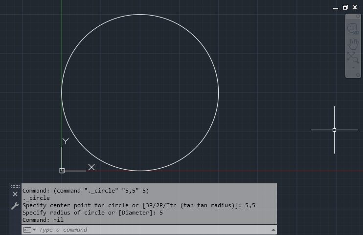

In the following steps, you draw a circle and zoom to the extents of the drawing using the command function.
  1. At the Command prompt, type (command "._circle" "5,5" 5) and press Enter.
    A circle is drawn on the current layer with a radius of 5 units at 5,5.

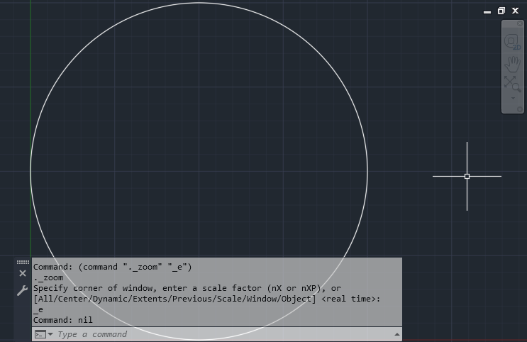

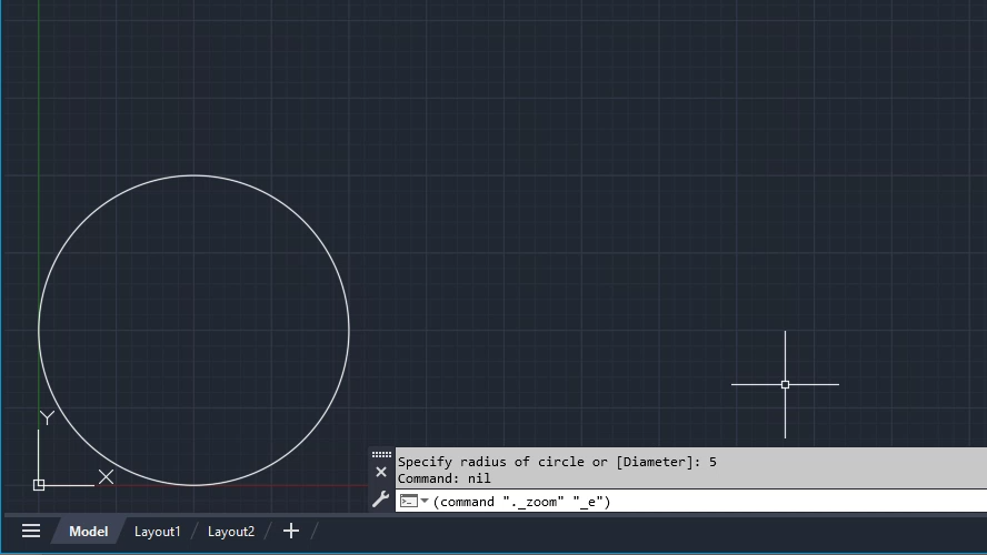

  2. At the Command prompt, type (command "._zoom" "_e") and press Enter.
    The drawing is zoomed to the extents of the circle if that is the only object in the drawing, else it zooms to the extents of all objects in the drawing.

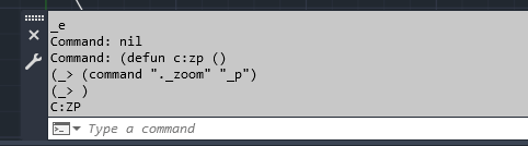

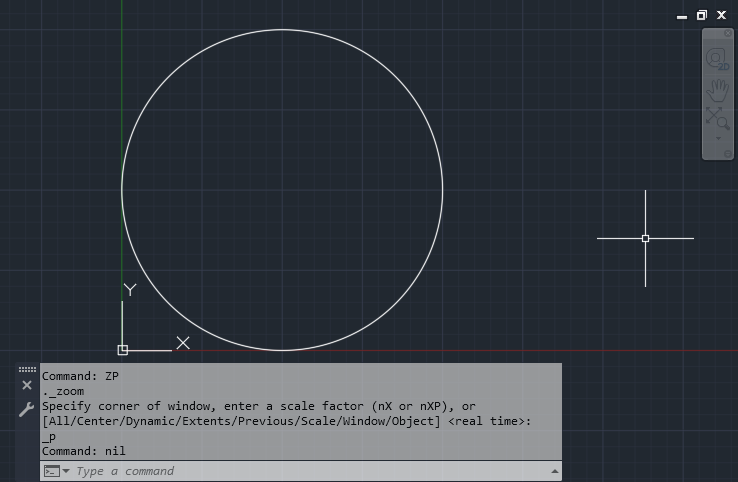

Let's give the defun function a try and define a custom command named ZP that zooms to the previous view of the drawing:
  1. At the Command prompt, type (defun c:zp () and press Enter.
  2. At the prompt (_>, type (command "._zoom" "_p") and press Enter.
  3. At the prompt (_>, type ) and press Enter.
    C:ZP is output to the command.
  4. At the Command prompt, enter ZP.
    The previous view is restored.
  5. Use the ZOOM or PAN command to bring the circle back into the current view.
  6. At the Command prompt, enter ZP.
    The previous view is now restored.

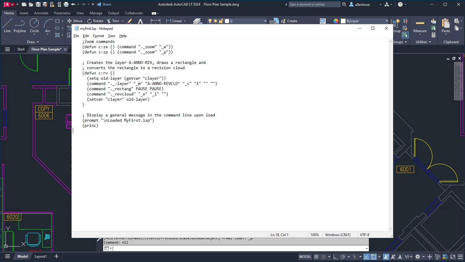

Now let's create our own file and load it into AutoCAD LT:
  1. In Windows, click the Windows Start button > Windows Accessories > Notepad or in the search box on the task bar enter notepad.
  2. In Notepad, type the following in the editor area:
    ; Zoom commands
    (defun c:ze () (command "._zoom" "_e"))
    (defun c:zp () (command "._zoom" "_p"))
    ; Creates the layer A-ANNO-REV, draws a rectangle and
    ; converts the rectangle to a revision cloud with arc lengths
    ; based on half the current value of the LTSCALE system variable
    (defun c:rv ()
      (setq old-layer (getvar "clayer"))
      (command "._-layer" "_m" "A-ANNO-REVCLD" "_c" "1" "" "")
      (command "._rectang" PAUSE PAUSE)
      (command "._revcloud" "_a" (/ (getvar "ltscale") 2) "" "_o" "_l" "_n")
      (setvar "clayer" old-layer)
    ; Display a general message in the command line upon load
    (prompt "\nLoaded MyFirst.lsp")
    (princ)

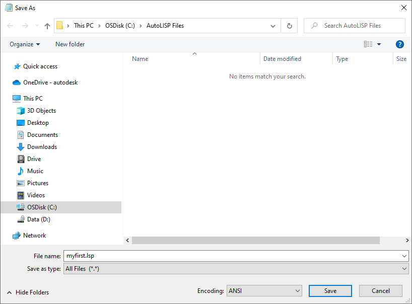

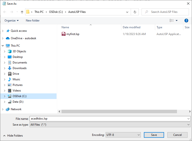

  3. On the menu bar, click File > Save As.
  4. In the Save As dialog box, navigate to the C:\AutoLISP Files folder.
  5. In the File name text box, type myfirst.lsp.
  6. Click the Save as Type drop-down list and select All Files (*.*).
  7. Click the Encoding drop-down list and select ANSI.
    If your programs need to utilize Unicode characters, select UTF-8.
  8. Click Save.

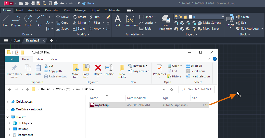

Now that you have created the file, instead of using the Load/Unload Application dialog box that is displayed with the APPLOAD command, you will load the LSP file using File Explorer.

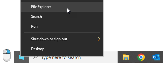

  1. In Windows, right-click on the Windows Start button and select File Explorer.
  2. In File Explorer, browse to the location of the myfirst.lsp file.

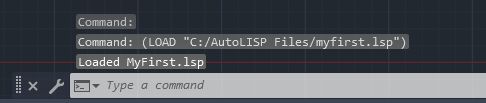

  3. Open a drawing in AutoCAD LT.
  4. Click and drag the LSP file over the AutoCAD LT drawing area.
  5. Release the mouse button to load the file into the drawing.
    Once loaded, you should see the message "Loaded MyFirst.lsp" in the command line window history which was displayed by the prompt function.

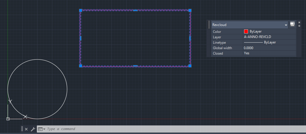

  6. At the Command prompt, enter RV.
  7. Specify two points to define the rectangular revision cloud.
    Notice the revision cloud is red and placed on the layer A-ANNO-REVCLD. This can be seen from the Layer drop-down list on the Layers panel of the ribbon or the Properties/Quick Properties palettes.
  8. At the Command prompt, enter ZE.
    The drawing is zoomed to its extents.
  9. At the Command prompt, enter ZP.
    The previous view of the drawing is restored.
Load AutoLISP Files with the Startup Suite
The Load/Unload Application dialog box can be used to not only manually load AutoLISP files as they're needed, but it can also automatically load AutoLISP files upon the opening or creating of a new drawing file. The Startup Suite area of the Load/Unload Application dialog box is used to specify which AutoLISP files to automatically load.
Note: This is an easy and convenient way to quickly load AutoLISP files automatically, but this must be done on each workstation in which you want to automatically load files. It is recommended to use a specialized startup AutoLISP file instead, which is covered in the Specialized Startup AutoLISP Files section.
Here are the steps used to add an AutoLISP file to the Startup Suite:
  2. In the Load/Unload Application dialog box, under the Startup Suite section, click Contents.
  3. In the Startup Suite dialog box, click Add.
  4. In the Add File to Startup Suite dialog box, browse to and select the AutoLISP file you want to have automatically loaded. Click Open.
    If you created the myfirst.lsp file in the previous section, you could select that file.
  5. Click Close twice to return to the drawing area.
    The AutoLISP file you added to the Startup Suite is automatically loaded into the current drawing.

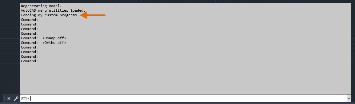

The following steps explain how to create the acadltdoc.lsp file in the C:\AutoLISP Files folder, add a few AutoLISP statements to it, load it into AutoCAD LT, and then verify the file was loaded.
    ; AutoLISP to be executed in each drawing created or opened
    ; Set Object Snap and Ortho modes
    (setvar "osmode" 4133)
    (setvar "orthomode" 1)
    ; Load the LSP file created earlier under the
    ; "Store AutoLISP Statements in AutoLISP (LSP) Files" section
    (load "myfirst.lsp" "\nMyFirst.lsp file couldn't be found")
    (prompt "\nLoading my custom programs")
    (princ)
  5. In the File name text box, type acadltdoc.lsp.
  7. Click Save.
  8. If AutoCAD LT 2024 isn't already running, start AutoCAD LT 2024.
  9. In AutoCAD LT 2024, create or open a drawing file.
  10. Press F2 to expand the command line window.
    In the command line window, you should see the message "Loading my custom programs" which is from one of the last two lines you entered earlier in step 2.
  11. On the status bar, click the Ortho Mode and 2D Object Snap buttons if they are blue to turn them off.
  12. Create or open a drawing file again.
    The status bar buttons should once again be enabled.

SECURITYOPTIONS Controls the security restrictions for running executable files in the product.

SECURELOAD Controls whether executable files are restricted to being loaded from trusted folders only. 1, may be locked by the CAD administrator Registry
TEXTEVAL Controls how text strings entered with TEXT (using AutoLISP) or with -TEXT are evaluated. 0 Not-saved
TRUSTEDPATHS Specifies which folders have permission to load and execute files that contain code. Varies, may be locked by a CAD administrator Registry
