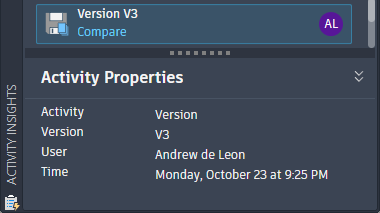

Activity Insights: The palette has a new refresh button, as well as improved search capability.
