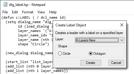

- Prompt the user for input at the Command prompt or with a dialog box using DCL (Dialog Control Language)
Programs written using AutoLISP can be stored in external files and loaded into the product when needed. These file formats can be used to store AutoLISP programs:
- AutoLISP Source Code (.lsp) file—an ASCII text file that contains AutoLISP program code
- Fast-load AutoLISP (.fas) file—a binary, compiled version of a single LSP program file
- Visual LISP Compiled (.vlx) file—a compiled set of one or more LSP and DCL files
