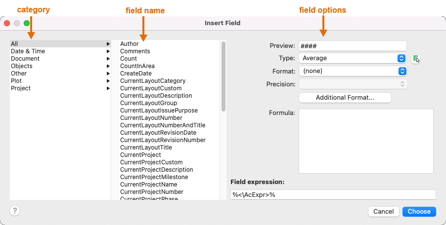

Share Email Facebook Twitter LinkedIn To Insert a Field in a Cell Click inside a cell. On the Table Cell visor, click Insert Field. In the Insert Field dialog box, select a category and a field name. Specify the options available for the selected field. Click Choose. Related Concepts About Adding Text and Blocks to TablesAbout Tables Related Tasks To Work with Blocks in a Table Cell Related Reference Commands for Tables
