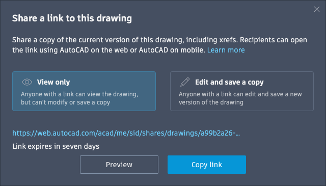

Share Current Drawing (What's New in 2023)
Share a link to a copy of the current drawing to view or edit in the AutoCAD web app. All related DWG xrefs and images are included.
Share works similar to ETRANSMIT in AutoCAD for Mac. The shared file includes all related dependent files such as xrefs and font files. Anyone with the link can access the drawing in the AutoCAD web app. The link expires seven days after it's created. You can choose between two permission levels for recipients: View only and Edit and save a copy.
New Commands
SHARE - Shares a link to a copy of the current drawing, including its DWG xrefs and images.
