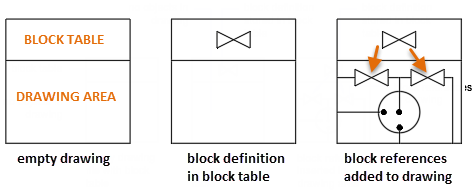

Each rectangle below represents a separate drawing file and is divided into two parts:
  • The block definition table
  • The objects in the drawing
When you insert a block you are inserting a block reference. The information is not copied from the block definition to the drawing area. Instead, a link is established between the block reference and the block definition. Therefore, if the block definition is changed, all references are updated automatically.
