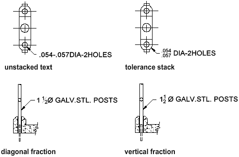

Stacked text refers to the fraction and tolerance formats applied to characters within multiline text object and multileaders.
You use special characters to indicate how selected text should be stacked.
  • Forward slash (/) stacks text vertically, separated by a horizontal line.
  • Pound sign (#) stacks text diagonally, separated by a diagonal line.
  • Caret (^) creates a tolerance stack, which is stacked vertically and not separated by a line.
Stack Numeric and Tolerance Characters Automatically
By default, numeric characters entered before and after a forward slash, pound sign, or caret will stack automatically. For example, if you enter 1#3 followed by a valid special character or space, the result is 1/3.
