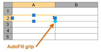

Insert Data Automatically
You can automatically increment data in adjacent cells within a table by using the AutoFill grip.
For example, a table with a date column can have the dates automatically entered by entering the first necessary date and dragging the AutoFill grip.
Numbers will fill automatically by increments of 1 if one cell is selected and dragged. Similarly, dates will resolve by increments of one day if only one cell is selected. If two cells are manually filled with dates one week apart, the remaining cells are incremented by one week.
