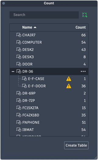

Displays a palette from which you can view and manage the counted blocks.
COUNTLIST (Command)
Menu: Window > Count.

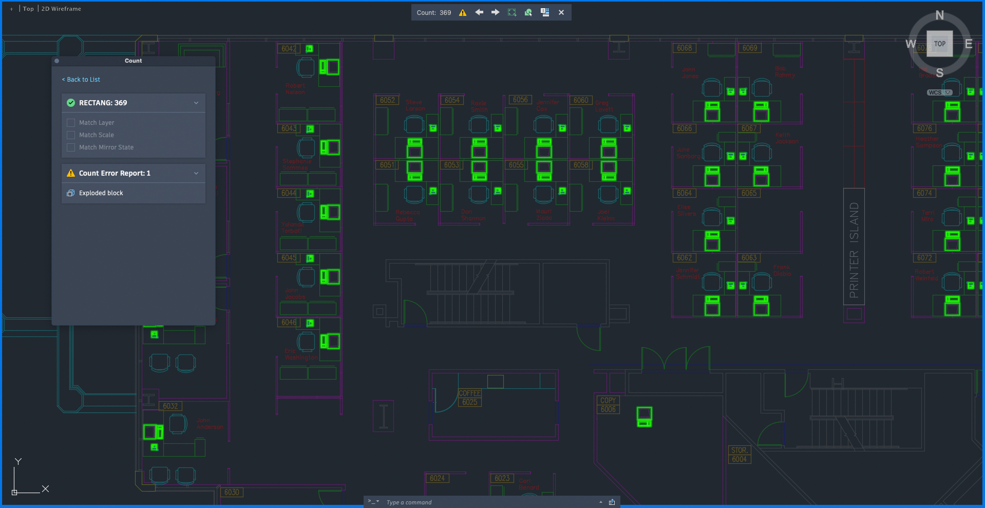

The Count palette displays the block names and the corresponding count of each block. When you are in an active count, the Count palette displays count details including the error report, if any. The report lists the count errors such as overlapping, exploded, or renamed objects.
List of Options
Generate Table
Inserts a table containing the block names and corresponding count of each block in the drawing.
Search
Filters the available blocks as soon as you enter the first few letters of the name or its keywords.
List of Blocks
Displays the block names and the corresponding count of each block found in the drawing. When multiple copies of a block are inserted in the drawing, and these copies have different properties, you can filter the count based on the general block properties such as the layer, scale, and mirror state. Additional filters are displayed for user-defined parameters and attributes of the counted blocks. Right-click to see filters.
