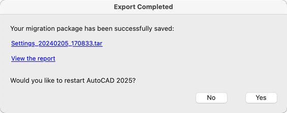

    You are prompted to save any unsaved drawings and then AutoCAD closes.
    The dialog box displays.
  6. Click View the Report to view details on which files were exported.
  7. Click Yes to restart AutoCAD.

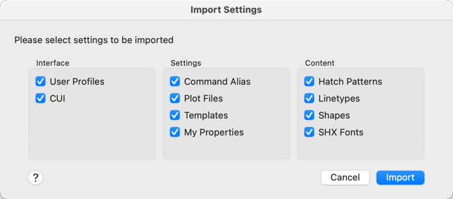

    The Import Settings dialog box displays.
  4. Select or clear settings as needed and click Import.

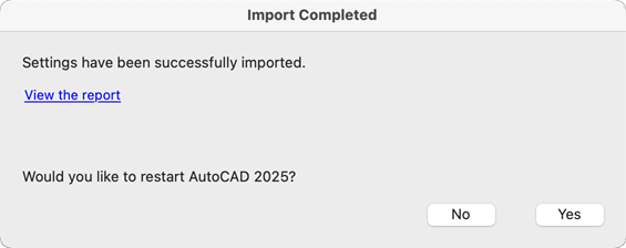

  5. Click View the Report to view details on which files were imported.
  6. Click Yes to restart AutoCAD.
