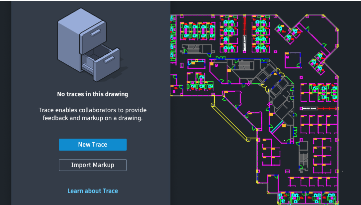

  • Pan performance is improved for drawings with raster images or wipeouts

  • Layout switching performance improvement
