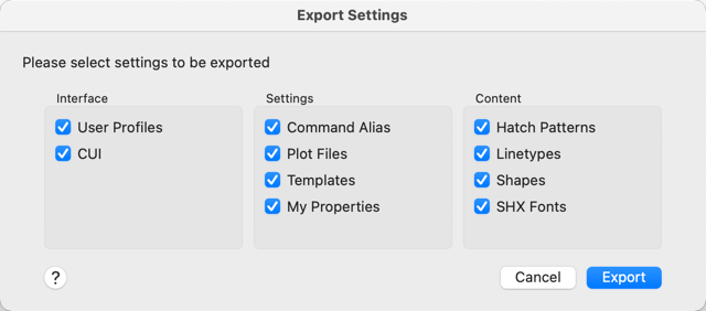

The Export Settings dialog box displays.
- Select or clear settings as needed and click Export.
- Enter a file name and location for the export file.
- Click Save.

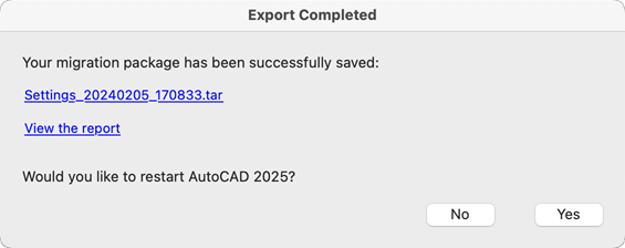

You are prompted to save any unsaved drawings and then AutoCAD closes.
The dialog box displays.
- Click View the Report to view details on which files were exported.
- Click Yes to restart AutoCAD.

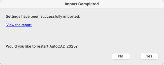

- Click View the Report to view details on which files were imported.
