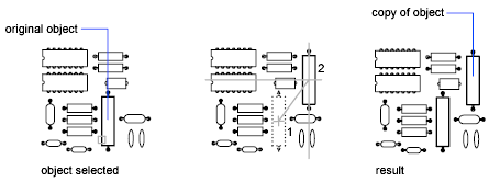

Specify Distance with Two Points
Copy an object using the distance and direction specified by a base point followed by a second point. In this example, you copy the block representing an electronic component. Select the original object to be copied. Specify the base point for the move (1) followed by a second point (2). The object is copied the distance and direction of point 1 to point 2.

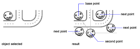

Create Multiple Copies
With COPY, you can create multiple copies from the specified selection set and base point. The options include the following:
  • Create copies at specified locations or displacements
  • Automatically space a specified number of copies in a linear pattern.
You can also select objects and drag them to a new location using the left mouse button over one of the selected objects; press Ctrl to make a copy. Using this method, you can drag objects between open drawings and other applications.
If you drag with the right mouse button instead of the left, a shortcut menu is displayed after you drag the objects. The menu options include Move Here, Copy Here, Paste as Block, and Cancel.
