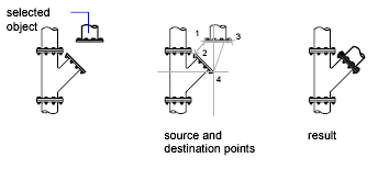

You can move, rotate, or tilt an object so that it aligns with another object.
In the following example, two pairs of points are used to align the piping in 2D using the ALIGN command. Endpoint object snaps align the pipes precisely.
