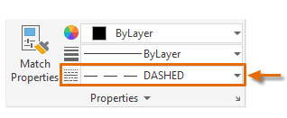

The current linetype setting defines the default appearance of all new geometric objects. You can see which linetype is current in the Properties panel of the ribbon Home tab when no objects are selected.

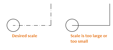

Linetype Scale and Short Segments
If the linetype of an object looks solid even though you assigned a linetype with a pattern, you may need to specify a different linetype scale for the object.
You can change the linetype scale of the object in the Properties palette to get the desired look.
