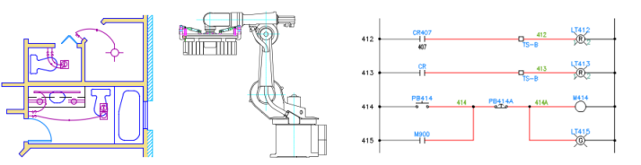

The line object is the most basic and common object in AutoCAD drawings of any discipline.
Each segment is a line object that can be edited separately, assigning properties such as layer, linetype, and lineweight. The simplest method to draw a line is to click two locations in the drawing area, however you will want your drawing to be much more precise.
