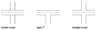

Create a Closed Cross Intersection
Multilines can intersect in a cross or a T shape, and the crosses or T shapes can be closed, open, or merged.
  1. Click Modify menu ObjectMultiline.
  2. Enter CC.
  3. Select the multiline for the foreground.
  4. Select the multiline for the background.
    The intersection is modified. You can continue selecting intersecting multilines to modify, or press Enter to end the command.
