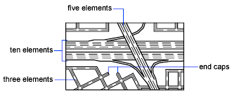

Multilines are composed of parallel lines, called elements.

Multiline Styles
Multiline styles control the number of elements and the properties of each element. The properties of multilines include:
  • The total number of elements and position of each element
  • The offset distance for each element from the middle of the multiline
  • The color and linetype of each element
  • The visibility of the lines, called joints, that appear at each vertex
  • The type of end caps that are used
  • The background fill color of the multiline
Elements with a positive offset appear on one side of the middle of the multiline; elements with a negative offset appear on the other side of the middle of the multiline.
