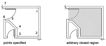

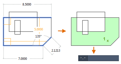

With the MEASUREGEOM and AREA commands, you can specify a series of points or select an object to find the enclosed area. While using the Quick mode in the MEASUREGEOM command, you can click within an enclosed area to display the calculated area and perimeter in the Command window. Perimeter calculations include those of enclosed interior islands.
Using Shift + click, adds or removes areas from consideration. The perimeters of enclosed islands as shown in the following illustration are also included.
Tip: Another fast way to find the area bounded by several objects in 2D is to use the BOUNDARY command to create a closed region or polyline. You can then use the Properties palette or the LIST command to find the area and perimeter.
Define an Area
You can measure an area enclosed by the points you specify. The points must lie on a plane parallel to the XY plane of the current UCS.

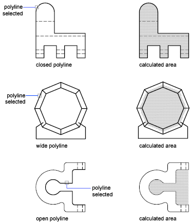

Calculate the Area, Perimeter, or Circumference of an Object
You can calculate the enclosed area and perimeter or circumference of circles, ellipses, polylines, polygons, regions, and 3D solids. The information displayed depends on the type of object selected:
  • Circles. Displays area and circumference information.
  • Ellipses, closed polylines, polygons, planar closed spline curves, and regions. Displays area and perimeter information. For wide polylines, this area is defined by the center of the width.
  • Open objects such as open spline curves and open polylines. Displays the area and length; the area is calculated as though a straight segment connects the start and end.
  • AutoCAD 3D solids. Displays the total 3D area of the object.
