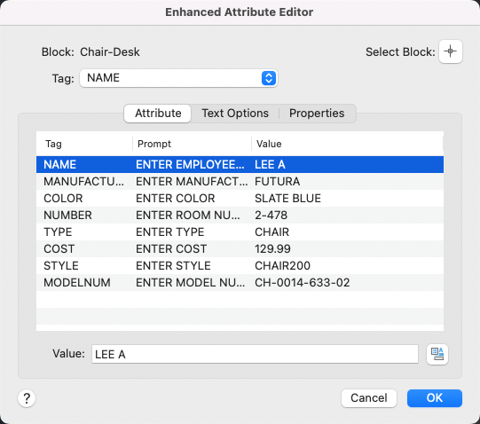

Attribute Tab (Enhanced Attribute Editor)
Displays the tag, prompt, and value assigned to each attribute. You can change only the attribute value.
List
Lists the attributes in the selected block instance and displays the tag, prompt, and value for each attribute.
Value
Assigns a new value to the selected attribute.
Single-line attributes include a button to insert a field. When clicked, the Insert Field dialog box is displayed.
Multiple-line attributes include a button with an ellipsis. Click to open the In-Place Text Editor with the ruler. Depending on the setting of the ATTIPE system variable, the Attribute Editor visor displayed is either the abbreviated version, or the full version

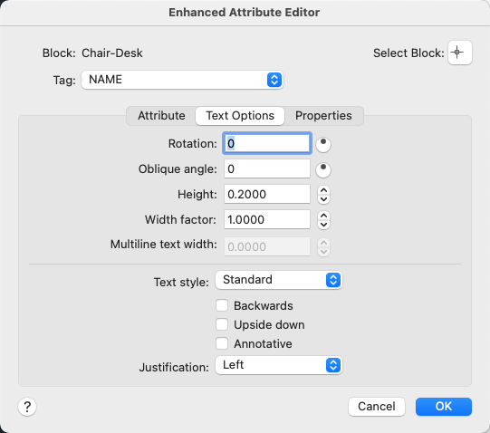

Text Options Tab (Enhanced Attribute Editor)
Sets the properties that define the way an attribute's text is displayed in the drawing. Change the color of attribute text on the Properties tab.
Rotation
Specifies the rotation angle of the attribute text.
Oblique Angle
Specifies the angle that the attribute text is slanted away from its vertical axis. Not available for multiple-line attributes.
Height
Specifies the height of the attribute text.
Width Factor
Sets the character spacing for the attribute text. Entering a value less than 1.0 condenses the text. Entering a value greater than 1.0 expands it.
Multiline Text Width
Specifies the maximum length of the lines of text in a multiple-line attribute before wrapping to the next line. A value of 0.000 means that there is no restriction on the length of a line of text. Not available for single-line attributes.
Text Style
Specifies the text style for the attribute text. Default values for this text style are assigned to the text properties displayed in this dialog box.
Backwards
Specifies whether or not the attribute text is displayed backwards. Not available for multiple-line attributes.
Upside Down
Specifies whether or not the attribute text is displayed upside down. Not available for multiple-line attributes.
Annotative
Specifies that the attribute is annotative. Click the information icon to learn more about annotative objects.
Justification
Specifies how the attribute text is justified (left-, center-, or right-justified).

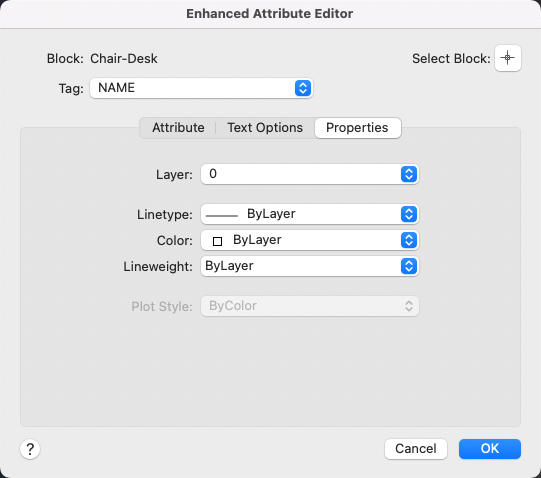

Properties Tab (Enhanced Attribute Editor)
Defines the layer that the attribute is on and the lineweight, linetype, and color for the attribute text. If the drawing uses plot styles, you can assign a plot style to the attribute using the Properties tab.
Layer
Specifies the layer that the attribute is on.
Linetype
Specifies the linetype of the attribute.
Color
Specifies the color of the attribute.
Lineweight
Specifies the lineweight of the attribute.
Changes you make to this option are not displayed if the LWDISPLAY system variable is off.
Plot Style
Specifies the plot style of the attribute.
If the current drawing uses color-dependent plot styles, the Plot Style list is not available.
