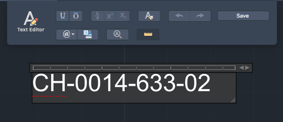

ATTIPEDIT (Command)
Changes the textual content of an attribute within a block.
Summary
If you select a single-line attribute, displays the In-Place Text Editor without the Text Editor visor. Right-click to display options.
Selecting a multiple-line attribute displays the In-Place Text Editor with the Text Editor visor.
Depending on the setting of the ATTIPE system variable, the right-click menu changes the formatting and editing operations available for compatibility with previous releases.
Note: Not all MTEXT formatting options are available for multiline attributes even with the full In-Place Editor.
