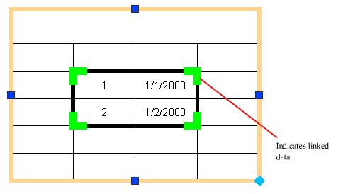

A table that contains data links displays indicators around linked cells. If you hover your cursor over the data link, information about the data link is displayed.
