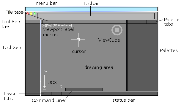

Parts of the User Interface
The user interface displays palettes and bars around the drawing area. Also, several controls are displayed within the drawing area.

  • Cmd-1 turns the Tool Sets on and off
  • Cmd-2 turns the Blocks palette on and off
  • Cmd-3 turns the Command Line on and off
  • Cmd-4 turns the Layers palette on and off
  • Cmd-5 turns the Properties Inspector on and off
  • Cmd-6 turns the Status bar on and off
  • Cmd-7 turns the References Manager palette on and off
  • Cmd-8 turns the Project Manager palette on and off
  • Cmd-9 turns the Materials Browser palette on and off
  • Cmd-0 turns full screen on and off
Palettes can be docked or floating.
  • - dock a palette
  • - undock a palette
