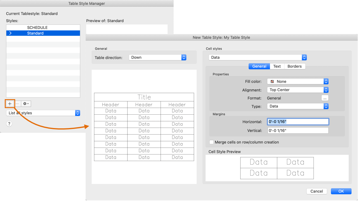

  1. Click Drafting tab > Table panel , or enter TABLESTYLE at the command prompt.
    Existing table styles for the current drawing are listed in the Table Style Manager dialog box.
  2. Do one of the following:
    • To create a table style, click .
    • Select the table style you want to modify, right-click and select Modify.
      The New or Modify Table Style dialog box displays.

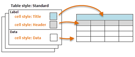

  3. Select the cell style from the drop-down list.
    There are 3 default cell styles: Title, Header, and Data.
  4. Update the properties for that cell style. Click the tabs General, Text, and Borders, to see all available properties for the selected cell style.
  5. Click OK to save all changes to the table style.
