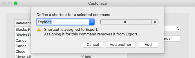

The visor displays.
- Start typing the command name you want to assign the shortcut key to. Select the command from the drop-down list.
- Click Record Shortcut.
- Press the keys you want to assign to the command.
Note: If the shortcut keys are already assigned to another command, an alert displays indicating which command uses the shortcuts keys.
- Select one of the following:
- Add. Add the shortcut key and exit the visor
- Add Another. Add the shortcut key and leave the visor open
- Cancel. Don't add the shortcut key and exit the visor
