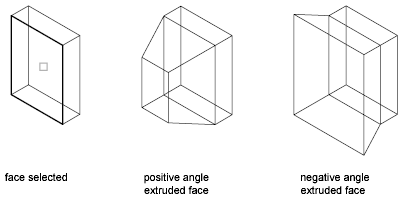

Height of extrusion
Sets the direction and distance of the extrusion. Entering a positive value extrudes the face in the direction of its normal. Entering a negative value extrudes the face in the direction opposite to its normal.
  • Angle of taper for extrusion. Specify an angle between -90 and +90 degrees.
    Tapering the selected face with a positive angle tapers the face in, and a negative angle tapers the face out. The default angle, 0, extrudes the face perpendicular to its plane. All selected faces in the selection set are tapered to the same value. If you specify a large taper angle or height, you can cause the face to taper to a point before it reaches the extrusion height.

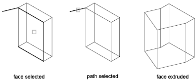

Path
Sets a path for the extrusion path based on a specified line or curve. All the profiles of the selected face are extruded along the chosen path to create the extrusion.
  • Select an extrusion path.
    Lines, circles, arcs, ellipses, elliptical arcs, polylines, or splines can be paths. The path should not lie on the same plane as the face, nor should it have areas of high curvature.
    The extruded face starts from the plane of the profile and ends on a plane perpendicular to the path at the path's endpoint. One of the endpoints of the path should be on the plane of the profile; if not, the path is moved to the center of the profile.
    If the path is a spline, the path should be perpendicular to the plane of the profile and at one of the endpoints of the path. If not, the profile is rotated to be perpendicular to the spline path. If one of the endpoints of the spline is on the plane of the face, the face is rotated about the point; otherwise, the spline path is moved to the center of the profile and the profiles are rotated about its center.
    If the path contains segments that are not tangent, the object is extruded along each segment and then the joint along the plane is mitred, bisecting the angle formed by the segments. If the path is closed, the profile lies on the miter plane. This allows the start and end sections of the solid to match up. If the profile is not on the miter plane, the path is rotated until it is on the miter plane.

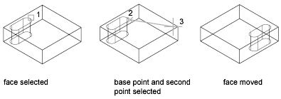

Face: Move
Move
Moves the selected face on a 3D solid object to a specified height or distance. You can select multiple faces at one time.
You can change the shape of the object by moving its faces. This option is recommended for minor adjustments.
Select faces
Specifies the face to be moved.
  • Base point of displacement. Sets the base point for the move. If you specify a single point, usually entered as a coordinate, and then press Enter, the coordinate is used as the new location.
  • Second point of displacement. Sets a displacement vector that indicates how far the selected face is moved and in what direction.

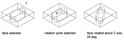

Face: Rotate
Rotate
Rotates one or more faces or a collection of features on a solid about a specified axis.
You can change the shape of the object by rotating its faces. This option is recommended for minor adjustments.
Select faces (rotate)
Rotates the face according to the specified angle and axis.
In the drawing area, select one or more faces.
Axis point, 2Point
Sets two points to define the axis of rotation.

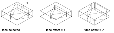

Face: Offset
Offset
Offsets faces equally by a specified distance or through a specified point. A positive value increases the size or volume of the solid. A negative value decreases the size or volume of the solid.
Select faces (offset)
Specifies the faces you want to offset.
Note: The size of holes inside a solid object that is offset decreases as the volume of the solid increases.
  • Specify the offset distance. Sets a positive value to increase the size of the solid or a negative value to decrease the size of the solid.

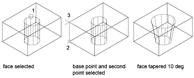

Face: Taper
Taper
Tapers faces on a 3D solid at a specified angle. The rotation of the taper angle is determined by the selection sequence of the base point and second point along the selected vector.
A positive angle tapers the face in, and a negative angle tapers the face out. The default angle, 0, extrudes the face perpendicular to its plane. All selected faces in the selection set are tapered to the same value.
Select faces (taper)
Specifies the faces to be tapered and then sets the slope of the taper.
  • Base point. Sets the first point for determining the plane.
  • Another point along the axis of tapering. Sets the orientation of the axis that determines the direction of the taper.
  • Taper angle. Specify an angle between -90 and +90 degrees to set the slope of the taper from the axis.

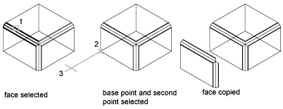

Face: Copy
Copy
Copies faces as a region or a body. If you specify two points, SOLIDEDIT uses the first point as a base point and places a single copy relative to the base point. If you specify a single point (usually entered as a coordinate) and then press Enter, SOLIDEDIT uses the coordinate as the new location.
Creates a new object with the original orientation and profile of the face. The result can be used as a reference to create a new 3D solid.
Select faces (copy)
Specifies the face to be copied.
  • Base point or displacement. Sets the first point to determine the distance and direction for the placement of the copied face (displacement).
  • Second point of displacement. Sets the second displacement point.

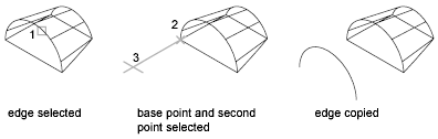

Edge: Copy
Copies selected edges on a 3D solid as 2D arcs, circles, ellipses, lines, or splines.
Retains the angle of the edge and allows you to make modifications and extensions, and create new geometry based on the extracted edge.
Provides a method for making modifications, extensions, and new 3D solids based on the extracted edge.
Select Edges (copy)
Specifies the edges to copy. Press Ctrl+click to select the edge. Then set the displacement:
  • Base point of displacement. Sets the first point for determining where the new object is placed.
  • Second point of displacement. Sets the relative direction and distance for the new object.

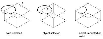

Body: Imprint
Imprints an object on the selected solid. The object to be imprinted must intersect one or more faces on the selected solid in order for imprinting to be successful. Imprinting is limited to the following objects: arcs, circles, lines, 2D and 3D polylines, ellipses, splines, regions, bodies, and 3D solids.
  • Select a 3D solid. Specifies the 3D solid to be imprinted.
  • Select an object to imprint. Specifies an object that overlaps the first selection.
  • Delete the source object. Specifies whether the object to imprint is removed when the operation is complete.

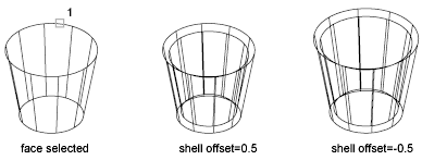

Body: Shell
Shelling creates a hollow, thin wall with a specified thickness. You can specify a constant wall thickness for all the faces. You can also exclude faces from the shell by selecting them. A 3D solid can have only one shell. New faces are created by offsetting existing ones outside their original positions.
It is recommended that you create a copy of a 3D solid before converting it into a shell. That way if you need to make significant modification, use the original version and shell it again.
Select a 3D solid (shell)
Specifies a 3D solid.
  • Remove faces. Specifies the face subobjects to be removed when the object is shelled.
  • Undo. Reverses the last action.
  • Add. Press Ctrl+click an edge to indicate which faces to retain.
  • All. Temporarily selects all faces for removal. You can then use Add to add the faces you want to retain.
Enter the shell offset distance
Sets the size of the offset. Specify a positive value to create a shell to the inside perimeter of the solid. Specify a negative value to create a shell on the outside perimeter of the solid.
