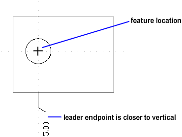

Locate the Leader
After you specify the feature location, you are prompted for the leader endpoint. By default, the leader endpoint that you specify automatically determines whether an X- or a Y-datum ordinate dimension is created. For example, you can create an X-datum ordinate dimension by specifying a location for the leader endpoint that is closer to vertical than horizontal.
