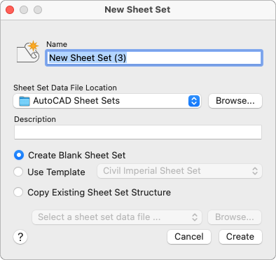

New Sheet Set Dialog Box
Creates a new blank sheet set, or a sheet set based on a template or one derived from an existing sheet set data structure.
NEWSHEETSET (Command)
Menu: File > New Sheet Set
List of Options
The following options are displayed.
Name
Specifies the name of the sheet set.
Sheet Set Data File Location
Specifies the path of the sheet set data (DST) file. The name of the sheet set data (DST) file is determined by the text entered for the sheet set name.
Click Browse to select a folder in Finder.
Description
Specifies a description for the sheet set.
Create Blank Sheet Set
Creates a new empty sheet set using the default settings and property values.
Use Template
Creates a new sheet set based on one of the standard sheet set template files.
A sheet set template contains a standard set of subsets, label and callout blocks, and other property values specific to an industry and unit of measurement.
Copy Existing Sheet Set Structure
Creates a new sheet set based on an existing sheet set data (DST) file. The new sheet set contains all the structure, sheet references, and property values of the specified sheet set data (DST) file.
Click Browse to select a sheet set data (DST) file in Finder.
