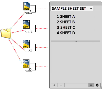

You can manage multiple drawings as sheet sets with the Sheet Set Manager.
Sets of drawings are the primary deliverable for most design groups. Sets of drawings communicate the overall design intent of a project and provide the documentation and specifications for the project. However, managing sets of drawings manually can be complicated and time consuming.
With the Sheet Set Manager, you can manage drawings as sheet sets. A sheet set is an organized and named collection of layouts, or sheets, from several drawing files. A sheet is a selected layout from a drawing. You can import a layout from any drawing into a sheet set or create new sheets from the Sheet Set Manager which creates a new drawing with a named layout.
